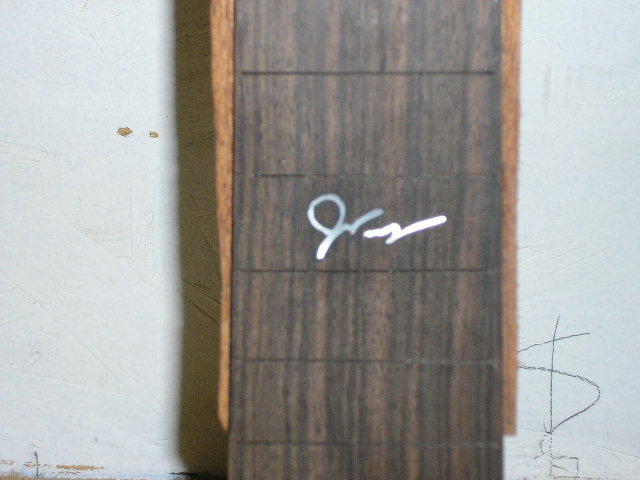

Since this is my first "miniture" inlay, I thought I would post a pic as well. This was difficult to cut, a small crack in the left hand piece but not to noticable. And just a little rough around the outside curve, on the same piece.
The owner wanted to have his initials or signature on the fretboard, so this is what he's getting, which is his signature.
Anyone else want to show off there stuff.Rod True38638.7933680556
